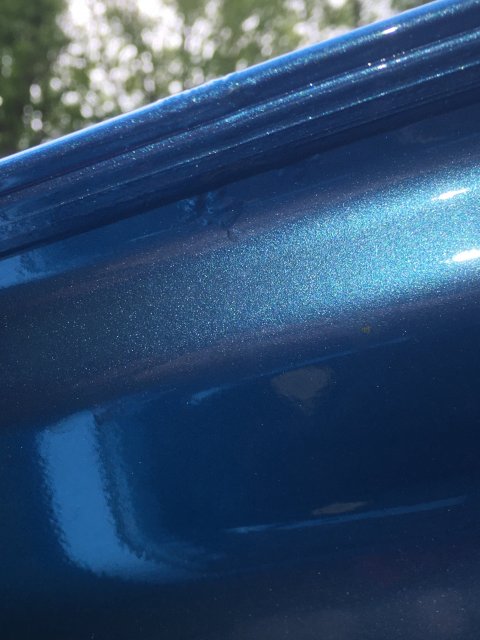

Just like the title states.
15,000 miles on my car. Clear bra and ceramic coated in 2018. Car gets stored over the winter and washed by me at least twice a week during the warm months. never driven in the rain. I don’t have a garage so it does sit in my driveway during the warm months.
Every year before it gets stored for the winter it gets a wash, wax and polish by the top detail shop in my area.

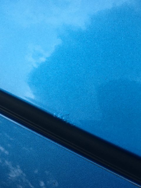

Washing it today and I see this on the leading edge of the hood, on the passenger side.

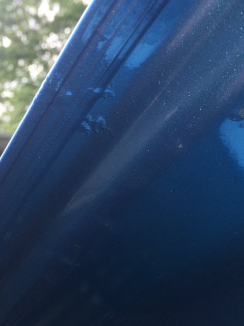

At first I thought it was the clear bra peeling but when I looked at the underside of the hood in that same area, I saw the same thing (second photo) in an area where there is no clear bra.
My car is a 2016, I know the power train warranty won’t cover this and I believe the bumper to bumper warranty only lasts 3 years (I have to check).
Questions i have.
1- is this a common issue with our cars? I’ve never seen a complaint about this before.
2- what’s the best way to deal with this thing? Repaint the entire hood?
3- should I get a new hood to repaint?
I always thought these pitting issues were a result of bad aluminum metal used to build the hood.

You describe it as pitting, but it looks to me like it's bubbling. It's not rust, because aluminum doesn't rust. From a quick search of the internet the most likely cause of bubbling is excessive moisture in the air lines during the painting process.
Bubbling is definitely a better term for it than pitting, thank you for helping me clarify it.
i can’t believe I didnt realize that it can’t be rust since aluminum doesn’t rust hahahaha.
its Definitely an issue with the manufacturing process.........either the paint or the aluminum.
I have to find out about this corrosion warranty if there is such a thing.
I wonder if I should take the clear bra off before I bring the car to the dealership.

Well, went down to the dealership first thing today.
I walked in, spoke to the service advisor I always deal with. Right off the bat, I showed him the service bulletin (linked earlier in this thread).
He punched in my information into the computer .......... long story short. The repair will be covered under my 5 year warranty.
he told me he is not going through the repair bulletin linked earlier in this thread. He’s just going to put it through my 5 year warranty which is actually set to expire at the end of this month. I bought the car back in May of 2016.
He asked me to peal off the expel paint protection film and drop off the car at the dealership as soon as possible. I ran home, peeled off the PPF and dropped the car back at the dealership this afternoon. Should be ready by the end of the week he said.
Im still nervous that the car is going to be sitting at the dealership and back and forth to their body shop, which is about 15 miles from the dealership.
I know of some of the horror stories that stem from dealerships having a car over an extended period of time.
I asked my service guy to take good care of the car and I gave him a little something as an incentive. I know the car won’t be under his watch the entire time but it still made me feel better about the situation.
stay tuned for results.
Hopefully this will help others who come across this issue with their paint..........it’s covered under the 5 year warranty.
