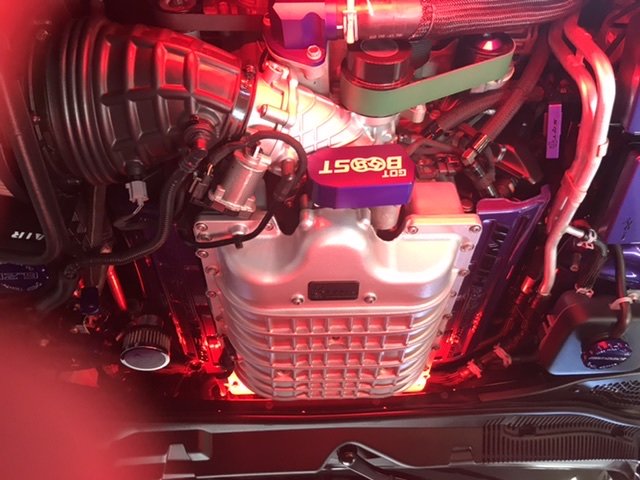

Well, speaking of cooling and superchargers. Before taking it to the dealer this morning after their flat insistence last week, they look at my SC under warranty. It seems the apparent pulley failure is not that clear! While totally cold, and totally clean, upon flipping the car into Track Mode this morning. The fans kicked on complete with an antifreeze/water mist! We smelled antifreeze at the track, and blamed it on a faulty cap @ the supercharger res. Well, it was simply getting splashed under the hood with the belts! Now since we understand that, we can begin to think about slipping supercharger belts, hot pulley, release of the pulley grease cap and front of the pulley until finally it puked its grease and began complaining bad, by not allowing the spin of the sc. So now I am glad Dodge is taking a good look at it for me, to restore it. We shall soon know what cut loose up there. Hell, maybe the SC pulley cap spun off and clipped the radiator?? Who knows? Interesting findings to come, I am sure. Make them more complicated, and these things will present more and more interesting problems.
Pulley let go, that's a given. Grease cap or no it has gone to failure. But the anti- freeze thing would be more worrisome to me as it is the unknown right now or the catalyst. Post this back on your pulley failure thread when done. Very interesting and a bit concerning to this RE owner. Also, in TOTAL agreement with your statement about how the more they add to these things the more goes wrong.(on other thread). I've had some glitches and problems with the RE already. Almost sorry I got it. My '09 SRT8 with aftermarket blower and tune, never gave me a minutes problem. I could go on about it, but we're already off topic and stealing this thread.

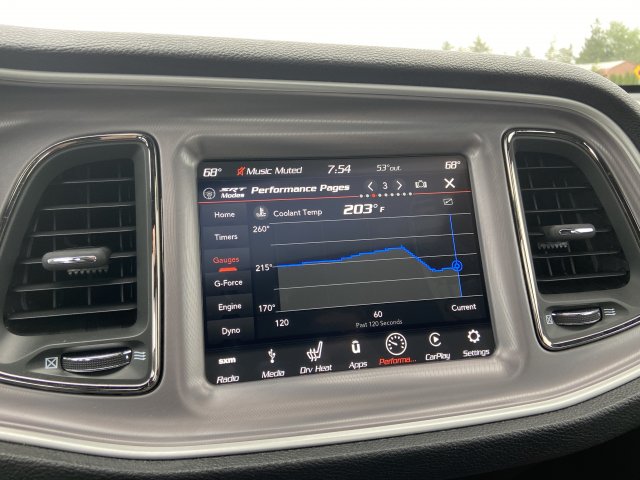

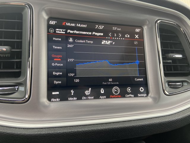

Okay, I'm too IT challenged to get this to post correctly!
But running hot at times that I am not running the car hard!

Those do not look unusual at all for the stock tstat.
