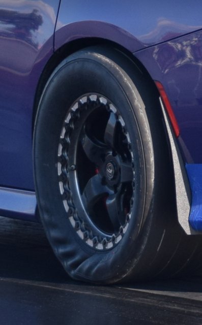

Went to the track Friday night and made 6 runs. 4 of which gave any useful data. 2 on the foot brake and 2 on launch control.
Foot brake off idle-ish (TC fully off) went 10.22 on a ~1.59 60.
Foot brake til probably 2000 (TC fully off) went 10.19 on a ~1.59 60.
middle pass was me going ZOMGWTFBBQ why isn't LC working. Smoked em for 200ft and about pegged the wall. Oops.
Launch Control (traction in sport) at 1300/1400 went 10.15 on a ~1.55 60.
Launch Control (traction in sport) at 1700 went 10.14 on a ~1.55 60.
All passes were red key, "707", trans track, suspension street, and traction either off on the foot brake or sport for the LC passes (must be enabled in some form for LC to activate).
I've been in this specific ballpark 2 different outings with similar weather conditions resulting in very similar 60's and ET's. Foot Brake seems to be effective enough by itself and LC/sport traction is at least comparable if not a hair more consistent...which I did not expect.
I believe I'm probably pulley or tune limited right now. The more boost I feed it under the curve the more it picks up in all areas. The 2.79 resulted in right at or just over 16psi at 6500rpm so in theory I COULD just run the flex tune all week (went 10.31 on the 2.95 pulley on said flex tune). I'd need to send data off to verify but I intended to pay for track support for the entire event so...
I'll probably get one more outing just to take some more life off the Mickey Thompson's before I put a fresh set on for drag week. Based on last year's final results even a consistent 10.15 would Place me in the top five. That would be an enormous victory for a first time event if I managed to finish all 5 days.
I will have a total of 16 days off between now and drag week so you could say it's crunch time. Especially considering work has me flying into North Dakota for the time being.

Nope. If anything the opposite.
Can't say the track wasn't prepped either:
